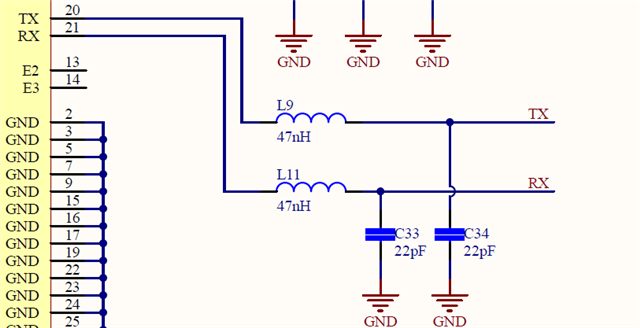

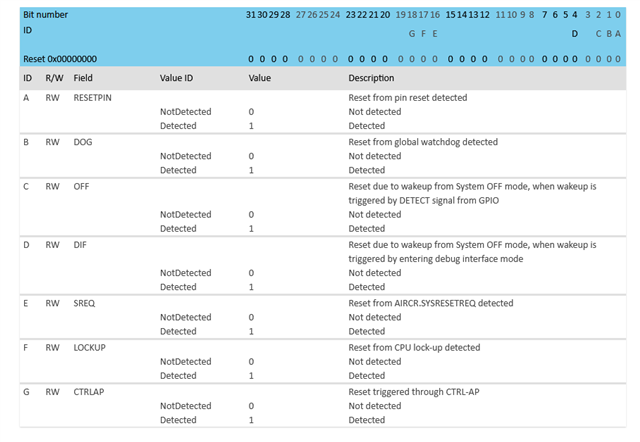

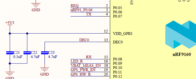

I have a custom board with a GPS chip and trying to communicate via UART2 on a nRF9160 using NCS 2.1.2.
When I try to write to the UART, the board reboots with no error messages. This was working when I had it set to
UART0 but changing to UART2 started this issue. Any thoughts would be appreciated.
