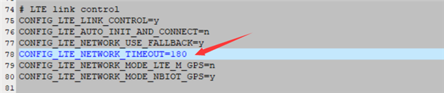

I used Nrf9160 to develop a product. Until yesterday, I had been able to connect to the nb network normally. But today, I found that my device could no longer register to the network. When I queried the modem status through the log, it returned the following information:
+CEREG: 5,0,"1D29","033E8D87",9,0,0,"11100000","11100000"
My problem is that since TAC and cell ID can be received, it means that the antenna can receive signals, and I also query the status of the sim card, and it is normal. What causes this problem?
