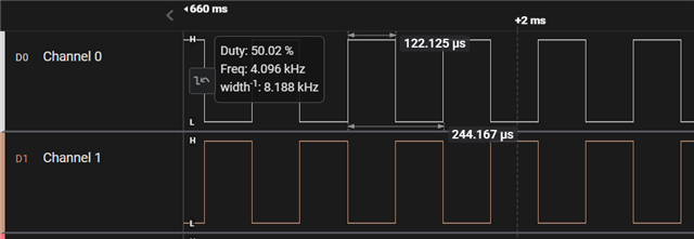

    The result on the P0.13 and P0.14 is exactly as I have expected:

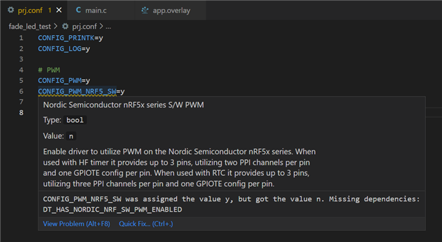

    but in VS Code I get the flowing "error" during the proj.conf edit:
    CONFIG_PWM_NRF5_SW was assigned the value y, but got the value n. Missing dependencies:
    DT_HAS_NORDIC_NRF_SW_PWM_ENABLED
    I have tried to search the GitHub for some cluses: https://github.com/zephyrproject-rtos/zephyr/search?q=DT_HAS_NORDIC_NRF_SW_PWM_ENABLED but I still do not know what I am doing wrong and how to fix the missing dependency on: DT_HAS_NORDIC_NRF_SW_PWM_ENABLED.

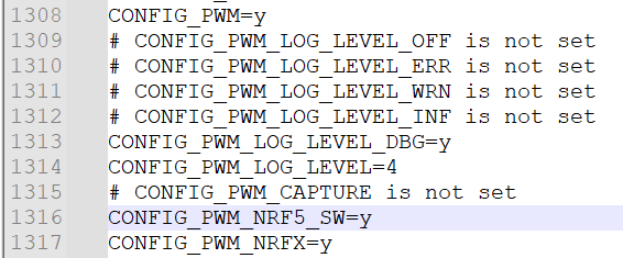

    How does this look in your end? Can you double check that the overlay files are used? If they are, then you should see that CONFIG_PWM_NRF5_SW=y in build/zephyr/.config. Is it?
    I see CONFIG_PWM_NRF5_SW=y in build/zephyr/.config:

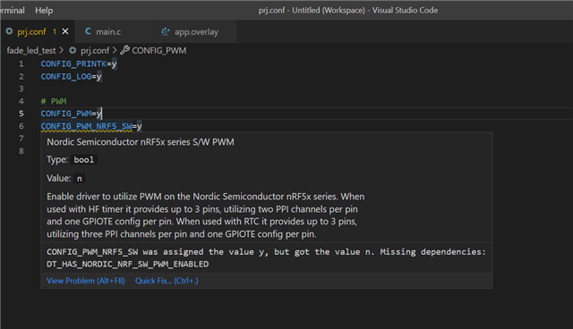

    As you can see I have set CONFIG_PWM_LOG_LEVEL_DBG=y to mimic your settings. I still see the same "error":
    At this point I will assume this is a minor issue related to VS Code and how it does the on the fly parsing. I will try to update to nRF Connect SDK 2.2.0 during the weekend and let you know if it changes something.
