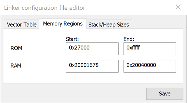

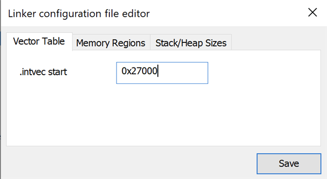

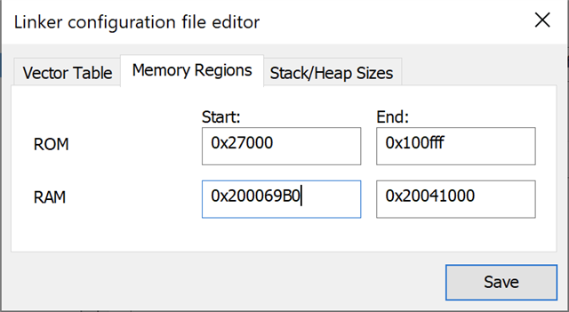

I'm trying to upgrade to SoftDevice S140 7.3.0 from 6.2.2 but when I program my DK board but it does not work at all. It looks like the application is not even executed. I initialize USB HID in my application but it is not recognized, no LED flashes while I have an LED blink in my code when the application starts.
What I did was replacing the header files in components/softdevice/s140/headers directory, modified the application RAM start
The SDK version is 17.1.0.
My project is created in IAR.
The memory adjustments are attached as a photo.
I use nrfConnect for programming the DK board.
Is there anything needed to be done that I don't do it?
I checked the attached files in Doc folder but there is not anything mentioned about defining a preprocessor of something.
