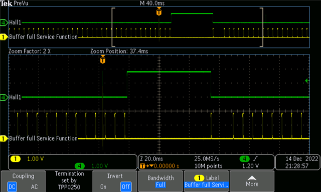

    I have connected a scope to a free pin and set it just at the beginning of the interrupt service function from the buffer full external interrupt from the accelerations sensor; just before leaving this ISF it is cleared. The ISF containing the reading out of the acceleration sensor buffer, calculation of the vector length and detection the biggest one takes 460 µs; this appears every 6.5 ms.
    I will connect a second pin which can be set and cleared at the start and end of the Hall sensor interrupt function for visualizing the system context.
    For the slowing down I have to think of a good trigger condition; this is perhaps not so easy...
    matthK
  • The green curve show the start and end point of the Hall interrupt service function; the yellow curve show the start and end point of the acceleration sensor buffer full interrupt service function.

  • Hi
    That's a long interrupt handler for sure, looks like the GPIOTE interrupt lasts for more than 50ms?
    From the graph it looks like the sensor buffer full interrupts are blocked by the GPIOTE interrupt, or are they not supposed to happen when you are in this state?
    If you are running such a long interrupt handler in the APP_IRQ_PRIORITY_MID priority it means you are blocking most other interrupts in the system, including callbacks from the SoftDevice informing you that something happened in the Bluetooth stack. It is quite likely that this will lead to issues with stability and performance.
    You could try just to set the interrupt priority to LOWEST or LOW instead of MID and see if it works better. Ideally though I would recommend running such a long processing stage from main/thread context.

  • Hi Torbjørn,
    I have made tests with LOW and LOWEST interrupt priority, but no change of behavior.
    But we found another point: When we ignore (see code below: added break statement) the PM_EVT_STORAGE_FULL event in the PeerManager  then it works perfect.

    So we assume that the garbage collector fds_gc() cause the issue.
    Should we keep it like that or replace by other code or execute at another time/place?
    matthk
  • Hi
    It makes sense that running this function in the middle of your sampling would cause issues. Deleting a page in flash could take as much as 80ms, and when running garbage collection multiple pages need to be erased at once.
    It would make more sense to check the status of the fds library occasionally using the fds_stat(..) function, and running garbage collection at some opportune moment when there is not a lot of other activities going on (based on the number of dirty pages reported by fds_stat()). For instance it is quite common to schedule garbage collection after you get a disconnect on the Bluetooth connection, since at this point you know that there will be no Bluetooth activity.

  • Hello Torbjørn,
    thanks for this input; we will work on that in the next days and run a lot of tests - might be that we close this subject not before the end of this year...
    What I can say is that even when commenting out the garbage collector we had some variations in the speed and acceleration values; when reducing the IRQ priority for GPIOTE from APP_IRQ_PRIORITY_MID to APP_IRQ_PRIORITY_LOW the values became perfect. The GPIOTE-, SAADC- and APP_TIMER-IRQ priorities are configured to 6 in sdk_config.h

  • Hi
    It makes sense that lowering the priority of the GPIOTE interrupt would help. The 50ms interrupt in your diagram clearly appears to block the sensor interrupts, causing them to be delayed by more than 50ms. I am sure if you make another plot now it will look very different.
