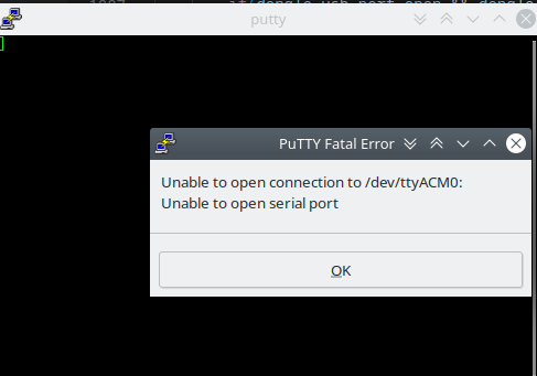

  • I'm using JLINK + Olimex ARM-JTAG 20-10 adapter , that connected to the target via SWD interface.
    The Dongle target is powered by the USB, I'm not using any external power.
    I'm opening the port using Putty on my Linux machine.-
    I find the port using the command " ls  /dev/ttyACM* ".
    When the application is running (with no debugger) the host recognize the port with no issues,
    Else, I get this error message when trying to open it.
    Do you think that my problem comes it low voltage when the debagging is activated? could you please elaborate more about it? and how could I test it?

  • Hi
    Just wanted to let you know that I tried to reproduce this on my end with an nRF52840 Dongle running the USB CDC ACM project, but connecting to the COM port worked fine both with and without a debugger connected to the device.
    So again, could it be related to voltage levels on your dongle specifically? USB probably activates REG0 with 1.8V output, but perhaps the debugger forces the VDD voltage to 3V or something on your end. It should work anyways though, but can you check the VDD voltage level on your Dongle with and without the debugger connected?
