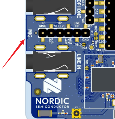

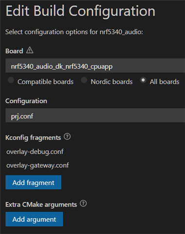

NCS2.0.2, 5340 audio DK, VScode, geteway mode
audio from Line IN, it work well, headset can head sound.
now i want audio from MIC, how to do it?

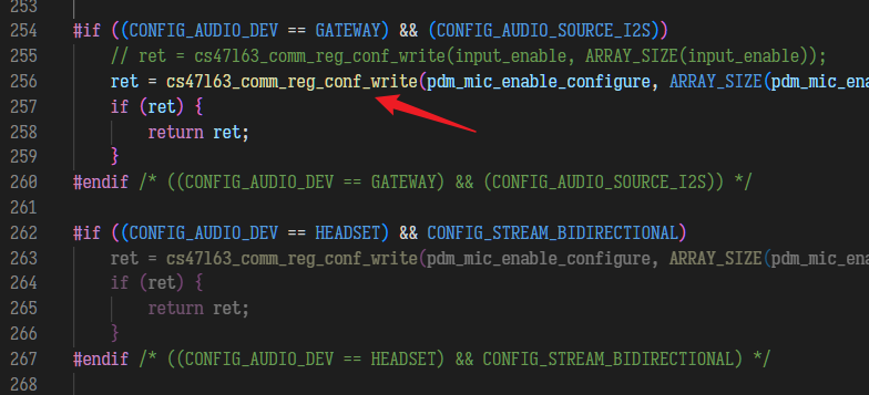

thanks for reply,
i want to use MIC in BIS mode, not from LINE-IN.
the same SOURCE_I2S from cs47l63.
i change as follow: talk face MIC BIS side, headset side no any sound.
Best regrds
thank you
i've find problem, only change one line as follow
but each vscode flashed will no sound, must use J_Link download ble5-ctr-rpmsg_3251.hex once,
yyes must each time. and then reset audio DK board.
otherwise, will got <err> ble: No response from NET core, check if NET core is programmed
maybe vscode earse net core but no flash to new.
