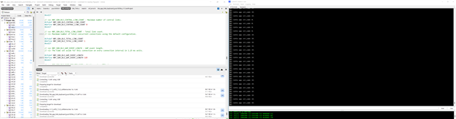

  • You might be filling up the SoftDevice buffer to fast. After 4 notifications queued/buffered, you are likely getting NRF_ERROR_RESOURCES returned. You could try to set NRF_SDH_BLE_GAP_EVENT_LENGTH in sdk_config.h to a higher value, e.g. 320. After this change, you likely need to allocate more RAM to the SoftDevice.
  • hi,
    I get log error code return in dataTransferHandler() function, and see that it return  0(NRF_SUCCESS) total 4 times, and 20 times remain return 19(NRF_ERROR_RESOURCES), NRF_ERROR_RESOURCES mean Not enough resources like that below:
    #define NRF_SUCCESS        (NRF_ERROR_BASE_NUM + 0)  ///< Successful command
    #define NRF_ERROR_RESOURCES              (NRF_ERROR_BASE_NUM + 19) ///< Not enough resources for operation
    So i think this is the main reason it only send 4 notifications to smart phone app..
    => Do you have sugestion for me?
    Below is my RAM and Flash configure:
    linker_section_placement_macros="FLASH_PH_START=0x0;FLASH_PH_SIZE=0x30000;RAM_PH_START=0x20000000;RAM_PH_SIZE=0x6000;FLASH_START=0x19000;FLASH_SIZE=0x17000;RAM_START=0x20002000;RAM_SIZE=0x6000"
    linker_section_placements_segments="FLASH RX 0x0 0x30000;RAM1 RWX 0x20000000 0x6000"
    Yes, as mentioned:
  • yes, i tried but the same.
    Do i need change more parameter?
  • Try to set the hvn_tx_queue_size directly as well, and see if it improves anything, snippet:
