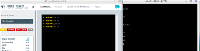

I installed the serial LTE modem application on my Thingy:91 so that I may use it as a standalone modem. Using minicom on my Linux machine, whenever I send an AT command I get no response from the device. However, if I use the LTE Link Monitor software to send a command while keeping the minicom session open, I get a response from the device within the minicom session instead of in the LTE Link Monitor window. I have also tried using PuTTY but I get the exact same result. Any suggestions or ideas on what might cause this issue and how to resolve it?

  • I built it from the precompiled package. The LTE Link Monitor is not my issue. The issue I have is that using a serial terminal, such as minicom or PuTTY, the modem does not respond to a single command; not one. However, when I use the LTE Link monitor it functions as expected. Even further, if I use the LTE Link monitor in conjunction with a serial terminal like minicom or PuTTY, I can send commands via the LTE Link Monitor and then receive the appropriate response via minicom or PuTYY; whichever I have open. I want to forego using the LTE Link Monitor entirely and only use a serial terminal application due to the type of development I am doing. Hopefully that clears up the context for you.

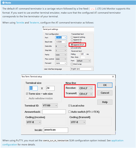

  • Hello again, the Serial LTE Modem documentation states the following under Connecting with a PC
    I've tested here with minicom and PuTTY, and it seems to work as it should.
    Let me know how it works for you.
