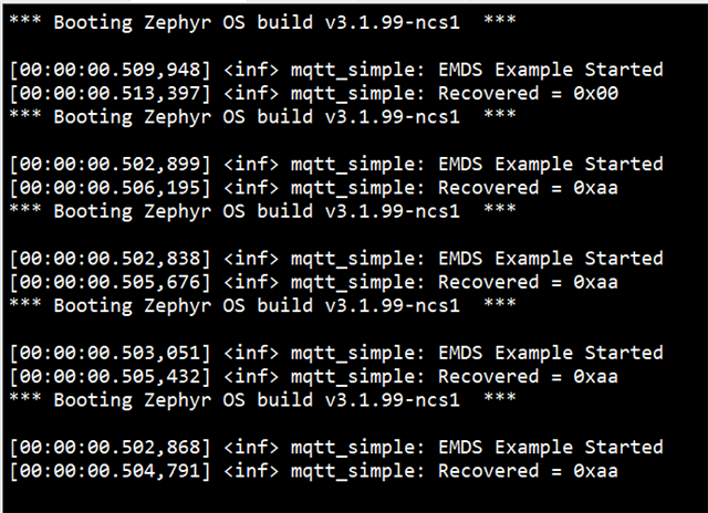

    I made a simple application that calls emds_store on a button press. It saves a generic buffer of 702 bytes. After the 5th press the device is bricked. This was build for the nRF9160 DK, NCS v2.1.0.
    emds_simple.zip
    This is what it output before being unrecoverable (until re-flashed)
    Thanks for your help.

    It seems that partial erase is currently not working as expected for the 9160 (non-secure build). If you remove the CONFIG_SOC_FLASH_NRF_PARTIAL_ERASE from the prj.conf the application works fine. The drawback is that the CPU will be halted during the erase operation. For most use cases this will not be an issue but we will investigate further so that partial erasing will be possible in the future.
    The issue has been reported to the responsible team. For now, by removing the partial erase option, you should be able to continue with the work.
