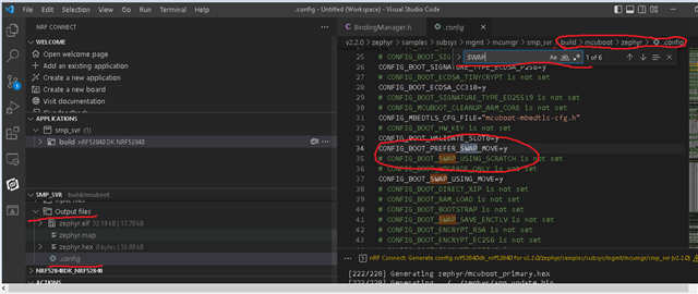

Also:
In my main file at startup, I check if the image is confirmed and the system reports it is not.
I do not know if this could cause a problem since at least when the debugger is running the code it always is never confirmed and the write confirmed does nothing.
  // DFU upgraded and not confirmed, confirm
  if (!boot_is_img_confirmed()){
    err = boot_write_img_confirmed();
      if (err) {
          d_printf(LINE_INFO,kDbg_Error|kDbg_Display,"BootConfirmErr:%d",err);
    }else{
          d_printf(LINE_INFO,kDbg_Error|kDbg_Display,"BootConfirmed");
Calling boot_is_img_confirmed() returns BOOT_FLAG_UNSET.
Calling boot_write_img_confirmed() calls boot_set_confirmed(); which calls boot_set_confirmed_multi(0);
In boot_set_confirmed_multi() state_primary_slot.magic=3 (BOOT_MAGIC_UNSET) and goes to done without doing anything!
   switch (state_primary_slot.magic) {
    case BOOT_MAGIC_GOOD:
        /* Confirm needed; proceed. */
    case BOOT_MAGIC_UNSET:
        /* Already confirmed. */
        goto done;
    case BOOT_MAGIC_BAD:
        /* Unexpected state. */
        rc = BOOT_EBADVECT;
        goto done;
github.com/.../1066

    I will give an answer to some of your questions now today so you have something to work with, and I will come back to verify the items below that needs some more input tomorrow.
    DavidKaplan said:
    After reading the  MCUboot documentation you inked, I understand that the swap-using-scratch is the default and that it may leave us with only 256 upgrades.
    Yes, that's correct for the case where you're performing DFU using scratch. However the default is swap using move if the SoC family is nRF, I am not 100% sure that is the case in your application if you've created it from scratch, so we'll have to look closer into this. Could you:
    1. Share your configurations (proj.conf and overlay files)?
    2. Could you navigate to <your app>/build/mcuboot/zephyr/.config and see what is enabled or not? As a sample here, you can see that by default the sample I've chosen uses move and not scratch.
    For reference, the sample where this .config is fetched from is this sample:https://github.com/hellesvik-nordic/samples_for_nrf_connect_sdk/tree/main/bootloader_samples/nrf5340/mcuboot_smp_ble_simultaneous
    Swapping using move should not cause the same issues as with scratch, so I might've been too fast in suggesting that the issue lies there. However, your configuration files should reveal if scratch or move is being used.

    As Andreas said, I will continue to help with this case.
    To make sure I have not missed anything, can you confirm if this is your current questions?
    1. You do want to know which swap type you use
    2. You are concerned that you have a limited amount of DFUs available before you use up the flash.
    Let me know if there was anything I have missed in the case.
    Swap Type:
    To figure out which swap type your project has, you can find that in VS Code after you built your project:
    Which swap type does your project use?

    I then programmed two sensors with the new code and then transferred the new image (with only the date changed) by my non-SMP BLE file transfer procedure.
    One sensor was programmed OK and the other not.
    I then connected the debugger and issued nrfjprog --readcode on both the good and bad sensors and uploaded to you the hex files along with the bootloader report.
    1.hex for the first sensor (failed) and nrfjprog --readcode 2.hex for the good sensor.
    The sensors will soon be in field tests and if I am doing something wrong, I need to know now.
    1) Does loading a new program when debugging count as an erasure?
    I have used sensor#1 quite a bit in debugging.
    2) I erase the slot on the sensor before starting its file transfer and do not use CONFIG_IMG_ERASE_PROGRESSIVELY=y.
    Would it be better to use progressive erasures and not erase it at the start?
    Before I start the DFU, I call img_mgmt_impl_erase_slot() to erase slot1 and flash_img_init().
    Then, I use img_mgmt_impl_write_image_data() to write incoming 512-byte blocks of the image.
    When I have finished writing the whole image to slot 1, I call img_mgmt_read_info() and img_mgmt_impl_write_pending()
    with the write pending permanent flag false. It is all in the code in my post.
    3) The default nRF52840 block size is 512 bytes. Would it help to increase it if possible?
    I tried once 1024 but it did not work or maybe I did not change the proper define.
    Thanks David
