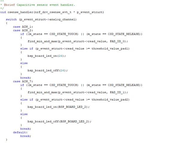

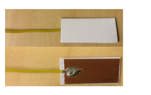

Im traying to test the csense drv example , I want touch pad  button only one
if  I want to use this configuration
put the USE_COMP == 0 to USE_COMP == 1
now  its ready
i connected the pad in AIN_1
i started the exaple
what is the next command ?
am i testing correctly?
if i touched AIN1 pin  26 change the state  on or off
im using a scope to see the pin output 26
i saw the documentation, but im no sure what is the problem

    Yes, you seem to be doing this correctly, there is no "next command" in the example project. After the pads are configured you should now be able to light up the LED(s) by touching the capacitive touch pad. Do you have any issues with this?

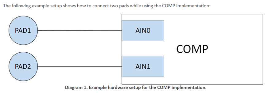

  • Hello
    maybe this es the problema i have two errors
    when i changed the USE _COMP == 1
    I thought I was using the COMP but it was the SAADC,
    thanks and regards
  • Hi
    USE_COMP and the ISOURCE feature is not present on the nRF52840, so that's likely why your application is failing when you enable the USE_COMP=1 define. Please set this back to 0 and the project should compile and build as expected.
    Simon
  • Hello Simon
    yes you right,
    I tested csesne example
    csense example
    I disabled PAD_1, PAD_2, PAD_3, PAD_4 sliders
    only use  BUTTON
    it works
    thank you and regards
