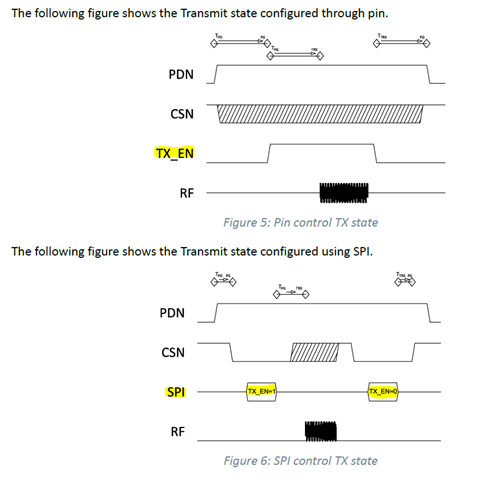

Question about TX_EN timing control of nRF5340+nRF21540
In SDK2.0.0 version, can the TX_EN timing of nRF21540 be changed through SPI control?
If the timing of TX_EN can be changed through SPI control, how FW implements SPI to control TX_EN timing?
Is there any FW sample for SPI based on nrf5340+nRF21540?
Any help would be appreciated.
Best Regards,
    The nRF Connect SDK does not have support for controlling the nRF21540 through SPI only. There is only support for GPIO only or GPIO + SPI. The implementation in the SDK uses only SPI for changing TX gain, and GPIO is used for TX/RX enable, antenna selection, 10/20dBm control using the MODE pin and PDN.
    If you want to use the SPI interface for controlling TX/RX enable you will have to implement this yourself.
