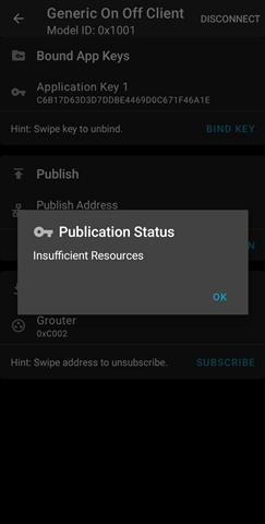

"Insufficient Resources" says nRF Mesh app
I am using Generic OnOff Server example and now i have added an Generic OnOff client model in same ELEMENT0 and have also added one more element ELEMENT1 with Generic OnOff Client model in nrf5 mesh sdk,
Everything seems to be working but i cannot able to set publish in more than one client model, it shows
what could be the problem??

    Its hard to see what might be the reason for this error, but I am guessing that it might be either
    • You might need to change a config that increases the size/increases the number of allowed elements or even storage for the number of elements
    • You might not be allowed to have the server and client in the same element. Have you tried separating them?
    Have you done any other modifications to the sample than adding one element? If so what?
