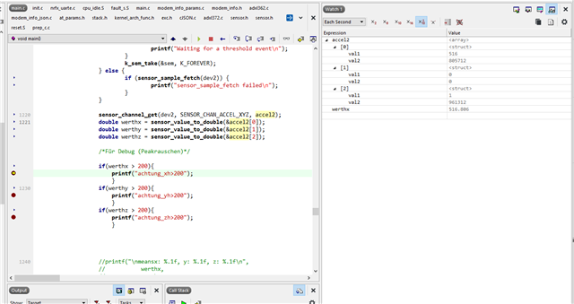

we have two Thingy:91 and we have a program based on mqtt_simple.
We capture acceleration values with the ADXL362 and the ADXL372 and send peak values as well as average values over longer periods of time via MQTT to our server.
Basically this works quite well, but I always get high peak values in between, even if the Thingy is just lying on the table.
Do you have an idea what the problem could be? Maybe a wrong configured filter? The problem is identical for both Thingys.
7 days:
12 hours:
My config is attached.
In addition, we get depending on  LTE_RECONNECT_DELAY_S  (120 min) 0,5° - 1° higher temperature values.  Do you have any idea what this could be?
The problem with the temperature is not a tragedy, but I am curious about it.

  • Hi Håkon,
    I think I now have the values you meant:
    I have set a breakpoint in a line if (werthx > 200).
    werthx = 516,806
    &accel2
    val1 = 516
    val2 = 805712
    Does this mean that it is more likely due to the config?
    Best regards
    Jürgen
  • Hi Jürgen,
    Sorry, I am not sure if I understand the question correctly. Perhaps you could rephrase it?
    Håkon
