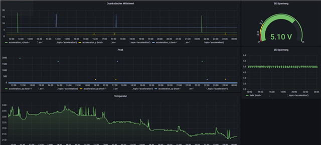

we have two Thingy:91 and we have a program based on mqtt_simple.
We capture acceleration values with the ADXL362 and the ADXL372 and send peak values as well as average values over longer periods of time via MQTT to our server.
Basically this works quite well, but I always get high peak values in between, even if the Thingy is just lying on the table.
Do you have an idea what the problem could be? Maybe a wrong configured filter? The problem is identical for both Thingys.

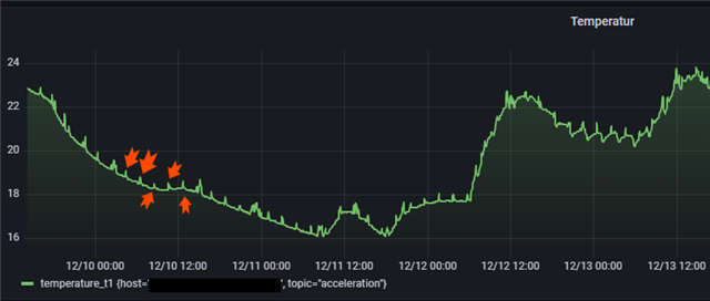

In addition, we get depending on  LTE_RECONNECT_DELAY_S  (120 min) 0,5° - 1° higher temperature values.  Do you have any idea what this could be?
The problem with the temperature is not a tragedy, but I am curious about it.

  • > The problem is identical for both Thingys.
    Does "identical" include the same time? Maybe you live in a earthquake region? Or close to a street with heavy vehicles? Or is it just the signal pattern, but at different times?
    I see CONFIG_MQTT_RECONNECT_DELAY_S or CONFIG_LTE_CONNECT_RETRY_DELAY_S. Which one did you test?
    I would use a PPK2 to measure the power consumption. Maybe the culprit is just a higher power consumption, if the device is "connected" for longer or "disconnected" for shorter.
    In my experience, the "heater" in a Thingy:91 is mainly the modem, it has the highest current consumption depending on its activation state.
    The other "heater" is the LiPo when getting charged. But that's more about 10° than 1°.
    The asset tracker v2 offers a
    config EXTERNAL_SENSORS_BSEC_TEMPERATURE_OFFSET
        int "BSEC temperature offset in degree celsius * 100"
        default 120 if BOARD_THINGY91_NRF9160_NS
        default 100
    to compensate the self heating when using protocols with higher power consumption.
  • Hello Achim,
    Thank you for your input. It is definitely not real accelerations (from earthquake or other accelerations) as these peak values are up to 2000 m/s² (the entire measuring range of the ADXL372)
    It's more of a noise and it occurs on both Thingys but not at the same time.
    Sorry, an error has slipped in. The higher temperatures occur in the interval of CONFIG_LTE_CONNECT_RETRY_DELAY_S.
    I do not charge the lipo during these tests. But the hint with the current measurement I will try.
    I will also look at the temperature compensation of the Asset tracker v2. Thank you very much.

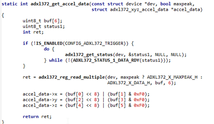

    It might be that you are reading peak values before they are ready. There is a flag in the STATUS register which is automatically checked if you are using the Zephyr driver.
    I have also received a longer reply form our team with suggestions regarding what this could be. I will provide you with an update later today.
    Regarding the temperature, I agree with Achim that this could be due to increased current consumption. It is a good approach to measure the current, for example with PPK2, and compare with the temperature readings.

    Yes, I am using the zephyr driver.
    I found the status flag, but doesn't that mean that only a value is output when the status is ready?
