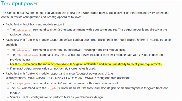

My goal is to output a constant carrier signal on the nrf21540-DK
I've loaded the radio_test on my nrf21540-DK.  The location of the test is /opt/nordic/ncs/v2.2.0/nrf/samples/peripheral/radio_test
However, the maximum power allowed in only 8dBM and I do not see support for the nrf21540-DK in the configuration files.
My question is how to run the constant carrier test using the nRF21540-DK?
