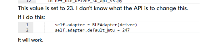

  • Did you follow the workaround mentioned in the case I pointed to ?
    Of setting self.adapter.default_mtu = 247 manually ?

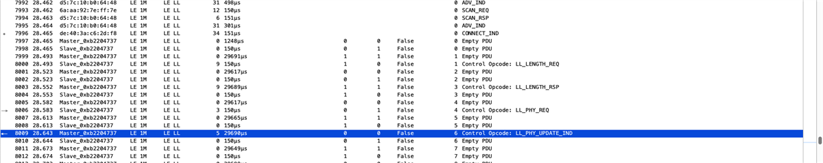

    Now with this, it communicates the event data length and PHY (the max - 251. But NOT MTU size or conn. interval. This can be seen from wireshark:
    I would have thought, like when connecting to anything else, the peripheral (server) should initiate these negotiations? I was wrong actually, it's the master that starts the MTU size negotiation. I saw this when comparing that trace, to another trace where I connect my peripheral to an iPhone X. So from OP's example in other post I added this code after the adapter connect.
    logging.info('Requesting MTU exchange')
    self.att_mtu = self.adapter.att_mtu_exchange(new_conn_handle, 517)
    And now it negotiates the right size. So actually my knowledge of the connection process was not quite correct. But at least now I know how it's meant to go.
