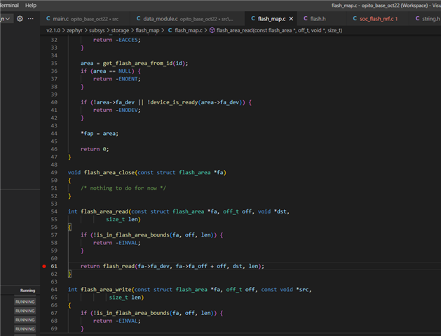

I have one unit, that somehow works, and when I loaded the code into any other blank devices it crashes.
The kernel panic provides hardly any info, but I'm pretty sure it is related to reading the config from storage and there is nothing there.
At settings_load_subtree, everything pauses for a couple of seconds, and then crashes.

  • whew - I found it.
    I loaded up ncs 2.2.0 and started porting my changes across, When I got to the indication LED. it faulted.
    I have a ws2812 LED, and am using PWM to drive it, I created a new module, that had subscribed to events, and shifted my init code into this module. this also included the init for the LED.
    So the AT2 was attempting to drive the LED, before it had been assigned any memory.
    It was weird that it was only crashing at the settings module, and if it could read the settings, it would work fine.
    I guess it was indeed a timing issue, if the unit booted fast enough, the LED would be init'd in the new module and all was well, if it took that teeny bit longer to search for settings it would crash.
    Thanks for the help! really appreciate it.
