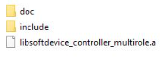

I try to use Soft Device Controller (sdc) on my application. I use VS Code, Zephyr and NRF Connect SDK v2.1.2 .
I got error during build. Could please help me on this?
Do you have any example with SDC with using Zephyr and NRF Connect SDK ?
CMakeLists:
cmake_minimum_required(VERSION 3.20.0)
project(blinky)
target_sources(app PRIVATE src/main.c dhlib/src/dh_nvs_data.c dhlib/src/data_logger.c dhlib/src/dh_console.c dhlib/src/proj_cmds.c src/proj_common.c  dhlib/src/dh_led_btn.c dhlib/src/dh_adc.c)
include_directories(dhlib/inc src)
set(MYLIB_LIB_DIR     ${CMAKE_CURRENT_SOURCE_DIR}/sdc)
set(MYLIB_INCLUDE_DIR ${CMAKE_CURRENT_SOURCE_DIR}/sdc/include)
add_library(softdevice_controller_multirole_lib STATIC IMPORTED GLOBAL)
add_dependencies(
  dhlib_project
set_target_properties(softdevice_controller_multirole_lib PROPERTIES IMPORTED_LOCATION             ${MYLIB_LIB_DIR}/libsoftdevice_controller_multirole.a)
set_target_properties(softdevice_controller_multirole_lib PROPERTIES INTERFACE_INCLUDE_DIRECTORIES ${MYLIB_INCLUDE_DIR})
target_link_libraries(app PUBLIC softdevice_controller_multirole_lib)
 conf file:
project folder:
sdc folder(from GitHub):
BUILD LOG:
