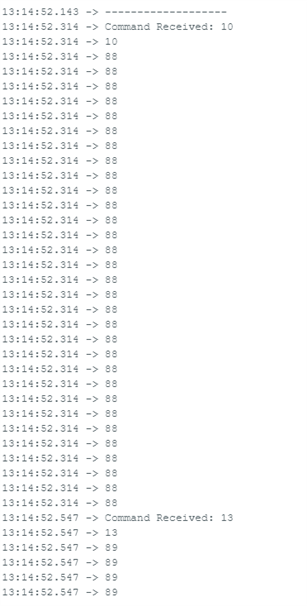

While communication I am facing following issues

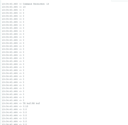

  1. When we send a single byte of data from SPI master and does not send ,or put zero in TX buffer of Slave - Then Slave receives correct data which is send by Master
  2. In above case Master does not receives any data.
  3. In other case When we send a single byte of data from SPI master and if we put non zero values in TX buffer of Slave - Then Slave receives incorrect data or garbage
  4. In above case also master does not receive any data
  5. When we send 32 Bytes of data from Master and put non zero values in TX buffer of slave - Then Master receives garbage values and Slave also receives garbage values

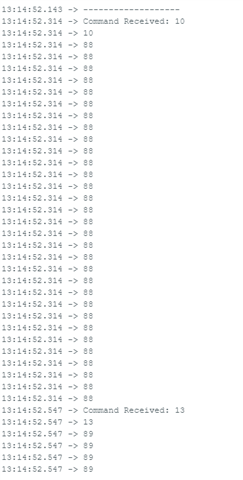

When NRF sending single byte and ESP send no data then
ESP side NRF side
When ESP send 0x01 , Here we can see that ESP side Rx buff receives an extra byte 80 even which is not send from Master side
When ESP send 0x01 and NRF send 32 Bytes of data , then  ESP RX buffer receives all garbage after that but in this case Master receives a single bytes which is send by Slave
In all above cases when, I disconnect the MISO line from Master side Slave side , then Slave receives all 32 bytes correctly , but as MISO line is disconnected so Master does not receives any data.
My observation is,  something is interfering with MISO line data . Even I have tested with different clock frequency also but nothing helps out.  What would be the possible cause of issue and what I am doing wrong in this communication ?Please help me with that.
