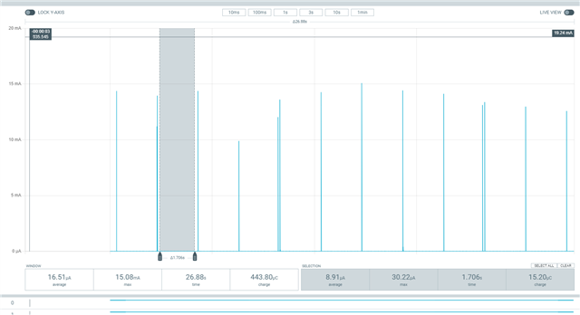

  • Hi Hariharan,
    I did a quick test here with the LPN example. What I found is that after LPN established friendship the current consumption should be around 16uA. What you have of 150uA or 700uA is still too high.
    Please try to test with the LPN example again. Did you test using our nRF52 DK ?
    Have you keep RTT logging when testing ? If you do please disconnect RTT or disable logging in the code.

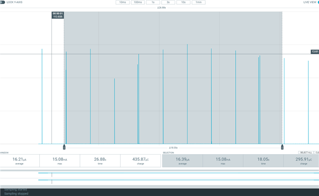

    Do you have a PPK2 (power profiler kit) ? If you do, you can capture the current consumption , for example here is what I have :
    You can find the consumption is around 16uA with a peak every 2 seconds for polling friend node.
    The idle current consumption is about 9uA:
    If you see a peak of 100ms , it was because of RTT_INPUT_POLL_PERIOD_MS = 100ms. If you set RTT_INPUT_ENABLED = 0 in nrf_mesh_config_app.h you will not have this 100ms wake up period.
    So if you see anything above dozen of uA , there must be something wrong. If you don't have a PPK2 I would strongly suggest to get hold of one.

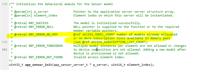

    Now, I want to integrate the sensor models into the application. When I tried to initialize the sensor models in the low power node example with the API - "app_sensor_init(&m_sensor_server_0, APP_SENSOR_ELEMENT_INDEX);" , the return code which I am getting is 4 (which corresponds to NRF_ERROR_NO_MEM). Can you help me troubleshoot this issue?

    Regarding your issue of NRF_ERROR_NO_MEM, if you read the description of the function , you can find this:
    You may want to increase ACCESS_MODEL_COUNT or ACCESS_SUBSCRIPTION_LIST_COUNT. Please try to debug if you see an error, you can step into the code and check why the function throws an error.
