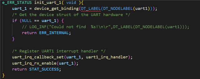

I'm getting the following error during migration from 2.0.0 to 2.1.0:

../src/nRF53_UART_1.c: In function 'init_uart_1':
c:\MatterLock\nRF_lock\build\zephyr\include\generated\devicetree_unfixed.h:12127:38: error: 'DT_N_S_soc_S_peripheral_50000000_S_uart_9000_P_label' undeclared (first use in this function); did you mean 'DT_N_S_soc_S_peripheral_50000000_S_uart_9000_P_reg'?

c:\MatterLock\nRF_lock\src\nRF53_UART_1.c:135:33: note: in expansion of macro 'DT_LABEL'
135 | uart_1 = device_get_binding(DT_LABEL(DT_NODELABEL(uart1)));

I am working on Custom board and here is my board folder .zip
