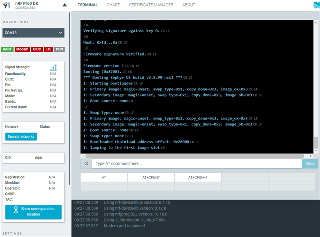

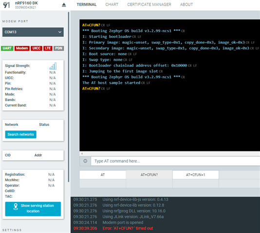

I have an nRF9160DK board, and I seem to have broken the modem.
I can't get any demo apps to work, and when I use LTE Link monitor, all AT commands time out.
I have a Thingy91 that works fine. I have looked at similar-sounding questions on here, but they didn't help.
Is there a "bricked" state of modem FW? Is there a way to get out of such a state?
How can I debug the modem when AT commands don't work?

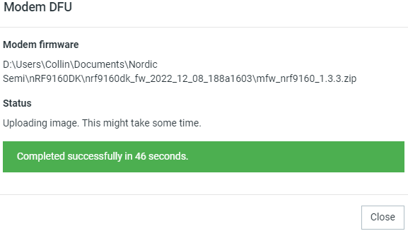

I did notice that my dev board is PCA10090 0.8.2, from 2018.49, and that I have updated to MFW 1.3.1 in nRF Connect Desktop's Programmer.
Could this be the problem? I have since uploaded mfw1.3.3, and Programmer says it completed successfully in ~46 seconds.
