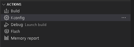

I am trying to enable the SPIM0 and TWIM1 drivers for my current project. Under the VS Code GUI for KConfig, I see the options, but they are grayed out and cannot be selected. Can someone guide me as to how to enable them? Maybe I have something enabled/disabled that is causing this. Manually adding them in the KConfig only produces compile errors. I am using nRF Connect SDK v2.1.2 and have the nRF52 DK (nRF52832) board for eval purposes.

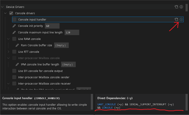

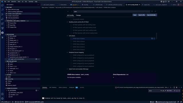

  • Hello Siguard,
    So the sample builds, compiles and flashes but I get nothing on the NRF RTT Terminal. A look at the prj.conf file shows 2 problems:
    1) CONFIG_NRFX_SPIM0 was assigned the value y, but got the value n. Missing dependencies:
    n
    2) CONFIG_NRFX_TWIM1 was assigned the value y, but got the value n. Missing dependencies:
    n
    I am running nRF Connect SDK v2.1.2 with nRF52 DK (nRF52832) eval board: PCA10040, 2.1.0, 2021.02.
    Please advise. Thanks!

  • Hi Adnan,
    You  are right, I forgot to check the build log.
    Instead of using CONFIG_NRFX_SPIM and CONFIG_NRFX_TWIM1, can you instead try to only set spi0/i2c1  in the devicetree?
    And enable CONFIG_SPI and CONFIG_I2C.
    Then I think the configuration system might handle the rest.

  • Hello Siguard,
    So in the echo_bot example I commented out the CONFIG_NRFX_SPIM0 and CONFIG_NRFX_TWIM1 configs in the prj.conf file and the overlay file already had the spi0 and i2c1 enabled as follows:
    &spi0 {
        status = "okay";
    &spi1 {
        status = "disabled";
    &i2c1 {
        status = "okay";
    &i2c0 {
    I built and flashed the sample to the board but again I do not get anything on the RTT.
    Please advise.
    Adnan
    So I added the following to the overlay file:
    &spi0 {
        status = "okay";
        sck-pin = <23>;
        mosi-pin = <25>;
        miso-pin = <24>;
        cs-gpios = <&gpio0 22 GPIO_ACTIVE_LOW>;
    &spi1 {
    &i2c0 {
    &i2c1 {
        status = "okay";
    I added the following to the prj.conf:
    #Enable SPI and I2C
    CONFIG_SPI=y
    CONFIG_I2C=y
    CONFIG_SOC_NRF52832_ALLOW_SPIM_DESPITE_PAN_58=y
    The following to the KCONFIG:
    config CONFIG_SPI_NRFX
        bool "Enable SPI NRFX"
        default y
        select CONFIG_SPI
    config CONFIG_I2C_NRFX
        default y
        select CONFIG_I2C
    Now I seem to have access to the SPIM and TWIM drivers!
    Please advise if this is the right approach?

    It looks like it should work.
    The following part seems redundant, since you already set CONFIG_SPI and CONFIG_I2C in prj.conf:
        default y
        select CONFIG_SPI
        default y
        select CONFIG_I2C
    To get started with SPI and I2C, see the following:
    Zephyr drivers for SPI and I2C.
    For C code, have a look at this spi test.
    For an I2C example, I always liked https://github.com/crfosse/ncs_projects/tree/main/peripheral_zephyr/i2c.
    For how to send serial data over Bluetooth Low Energy, the Peripheral UART sample  should be relevant.
