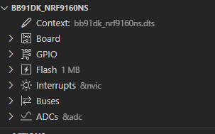

    I add a new board bb91dk_nrf9160 modified from nrf9160dk_nrf9160 to the attached sample.
    You can adapt for your custom hardware with an overlay first then add them to the devicetree file.
    The device tree configuration can be verified from the following nRF Connet for  VS Code window.
