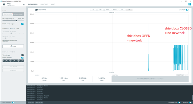

    I can add some information. In the following pic you can see the power consumption profile of the DK with the UDP example, running with 3600s PSM sleep, 60s active time, as well as 3600s data send period.
    In the first pic you can see the power consumption when the DK is powered up inside a shield box (= no network). You can see there are continuos retries of approximate duration of 10 minutes. How to control the backoff time? We want the retries to be at least one hour away, in order not to waste battery power.
    In the second pic you can see the DK being powered on with the shield box open (= network) and after the first connection, while in PSM, the shieldbox is closed (= non network). The retry pattern restarts after one our when the software tries to send data. Again: how can we control a timeout and a backoff? And try the next hour just for less minutes?
    Thanks in advance! Let me know if anything is unclear.
  • Sorry for the slow response to this ticket.
    The solution to this issue could be the use of Periodic cell search configuration %PERIODICSEARCHCONF, this is found in LTE Link Controller library under lte_lc_periodic_search.
    For your application it may also be good to use Modem domain event notification %MDMEV and Search Status 1 which allows your application "a chance to stop the modem from using more power on searching networks from possibly weaker radio condition". The modem team also suggests the following:
    • Limit the used bands with band lock as much as possible, i.e. inform modem which bands can be skipped.
    • Resolve suitable relation between light searches and full searches for the use case. Let's say for example that application tries to send data once per hour. The relation of light and full search could be that only light search is done by default (modem deactivated after light search done), but if sending of data has failed 4 times in a row, then full search is allowed for the fifth attempt to send data. This way we make sure that all bands are fully scanned at least at some point (every fifth attempt).
    Let me know how this works for you!

  • Dear Oyvind,
    thanks for your answer!
    I also see that it is possible to change the %XDATAPRFL setting and that has impact in the periodic search conf.
    Would you recommend to try the %XDATAPRFL which seems an easier approach first?
    Marco
