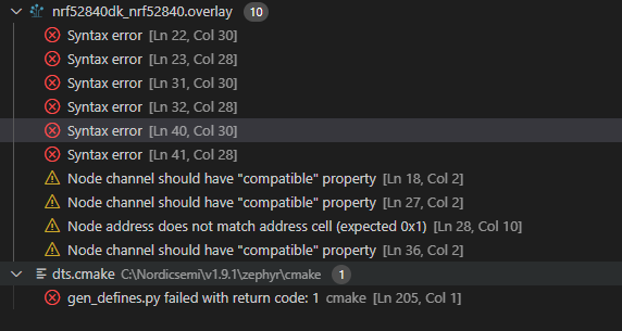

  • By trying your method, I'm getting various errors from CMake and a lack of definitions. I'm using NCS V1.9.1.
    I'm attaching the list of errors and my project.
    adc_extended.zip
  • adc_4.zip
    So I did some googling. It builds well yet suffers from failure while trying to start channel 0. What did I miss here?
