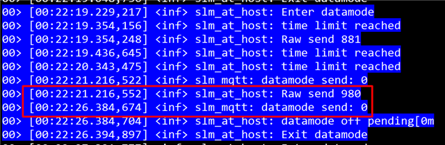

    I'm using the SLM FW (SDK: 2.0.2), and I'm sending ~1KB/s. I tried to double the size of CONFIG_NRF_MODEM_LIB_SHMEM_TX_SIZE but it doesn't seem to change anything.

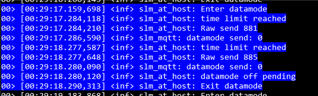

    The RTT log shows a gap between Raw send and datamode off pending. that's the place I saw the modem's slow responses.
    for reference, this is the normal situation, only 3 ms delay between raw send and datamode off pending
  • Did you also try to increase CONFIG_NRF_MODEM_LIB_HEAP_SIZE and CONFIG_NRF_MODEM_LIB_SHMEM_CTRL_SIZE?
    How often or consistent is the gap?
    Could you also enable logging in the MQTT library, and send me the log?
    CONFIG_NET_LOG=y
    CONFIG_MQTT_LOG_LEVEL_DBG=y
    (and, if you haven't already, enable debug logging in the SLM itself).
  • Hi Didrik,
    The log shows the client_write_msg takes an unusual amount of time to finish. Normally, it takes less than 10 ms to finish writing 1 kB of data.
    I've increased the CONFIG_NRF_MODEM_LIB_HEAP_SIZE, and it seems to reduce the frequency. I'll keep monitoring.
