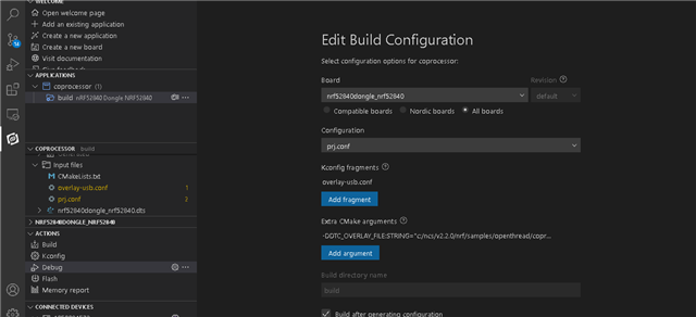

  • Oh aha, I think that your first issue is that if you just open a normal terminal and run west, it will not be configured.
    Since you are using the Toolchain Manager to install, use the Toolchain Manager to open a terminal if you want to run west commands from the terminal.
    Or the nRF Connect Terminal as you mention:
    jahess said:
    After trying the nrf one and from the vscode terminal session I see what is listed below.
    Instead of running it in the terminal though, try to add the extra configurations using VS Code.
    You do this in "Extra CMake Arguments", as such:
    Does that work for you?
    Sigurd Hellesvik

  • Sweet.  It builds.  Your screen shot also showed me that the conf and overlay files go in different settings...
    Thank you, Sigurd!
