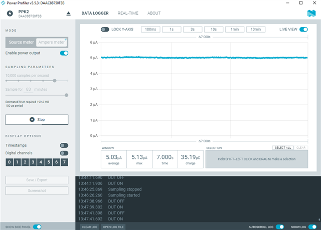

I am trying to monitor the GPIO pull-up drive capability of a microprocessor using a PPK2 module in "Ampere meter" mode.
PPK2 VIN is connected to the GPIO pin and VOUT to a 1Kohm resistor to ground.
Although the current verified with a multi-meter to be around 25uA, PPK2  is measuring values around 5uA:
Is this a limitation? Using 10K resistor seems to solve the issue.
