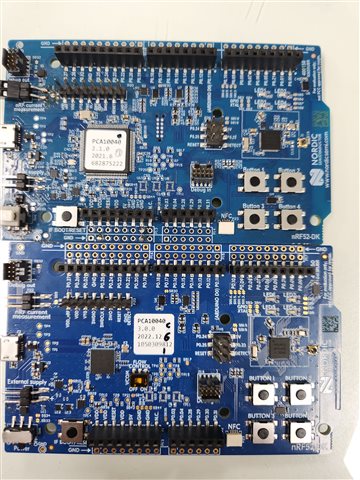

  • hi jared
    I'll share a picture of the two dk board
    The above one is the dk board written as 2021.06 and the below one is the dk board written as 2022.12

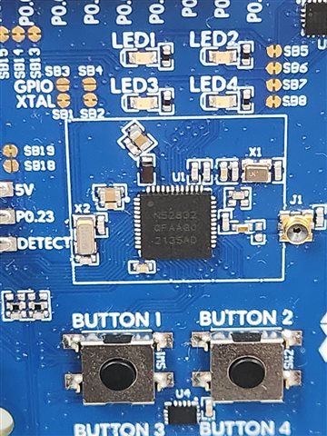

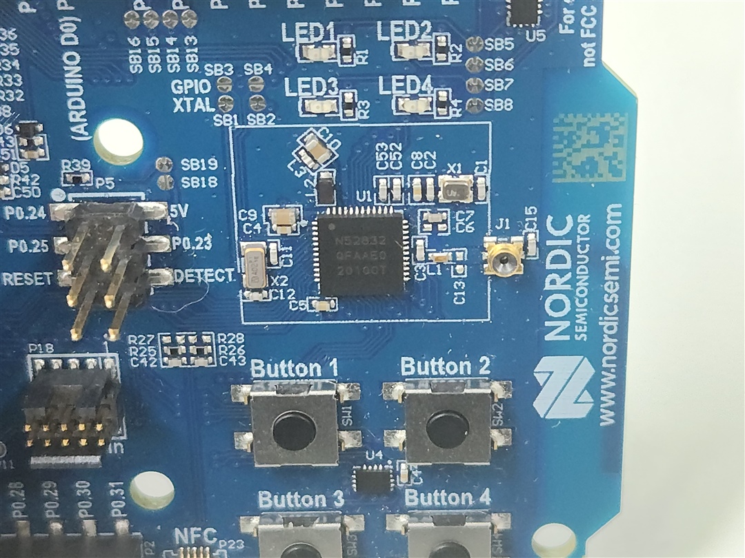

    and the full ic marking of both ICs on dk board is here:
    the above marking (N52832 / QFAAG0 / 2135AD) is ICs marking on dk board written as 2022.12
    and the other marking(N52832/QFAAE0/2010CT)  is ICs marking on dk board written as 2021.06
    There is two distinct differences between the two revisions of the development board,
    1. The 2021.06 board use a third party device as the onboard interface device, while the 2022.12 use our own nRF5340 as the interface device.
    2. The 2021.06 has a revision Ex0 nRF52832 IC while the 2022.12 has a revision Gx0. Revision Gx0 has different app port protection mechanism than the Ex0. For Gx0 and later, access port protection is enabled by default, which means that the debug interface will be disabled if the app protect isn't disabled explicitly. The app protect protection can be disabled temporarily while debugging the device but if it's not disabled properly in the user code it will be enabled after a pin reset or power on reset. Revision Ex0 and earlier do not have the app protect mechanism enabled by default. I think what you observe is a result of this difference but I don't quite understand why you see a different behavior when you do a pin reset vs a power cycling the board as both should result to the same.
