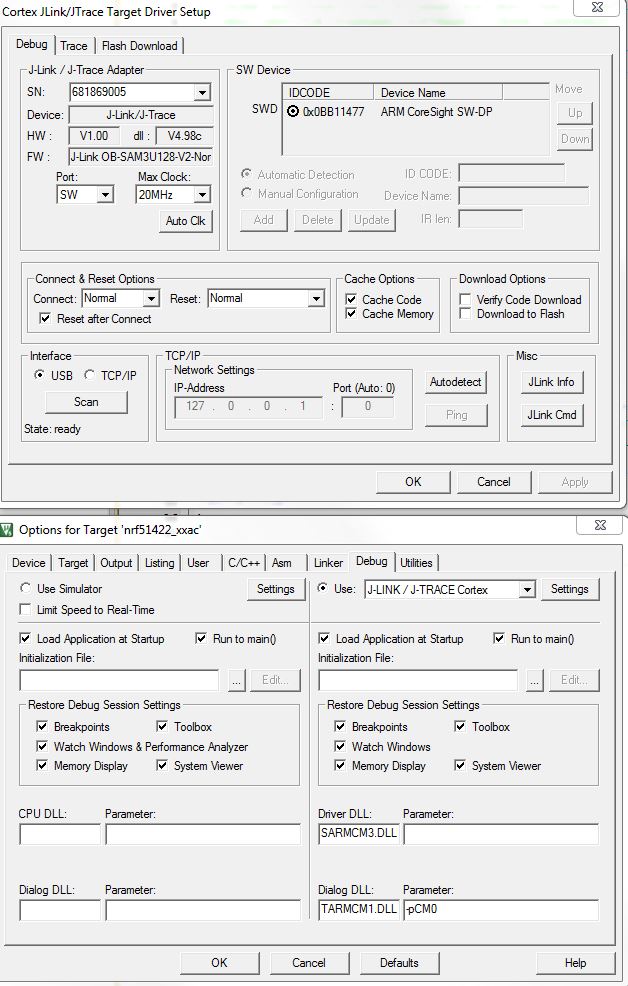

  • Hello Petter, thanks for your help. As you suggested I had inserted a breakpoint on main loop line number 573/power_manage. Let me resume what´s happen:
    1 - Keil sends a message telling "No ULINK Device found". My board is PCA10028 and SEGGER ID is 681092855.
    2 - Sometime fore after a message appears "Starting dll Debug Session system return error. Target dll had been cancealed, debugger abborted" and no additional information can be retrieved.
    Can you help please?
    Thanks and regards. Luis
  • I guess you are not using a ULINK since you are using the PCA10028 DK which has a JLINK.
    Your settings should be something like this:
    image description
    Edit 05.11.2015:
    1. Open nRFgo Studio.
    2. Select your nRF51 development board
    3. Click Erase All
    4. Click Program SoftDevice tab
    5. Browse and Program this.
    6. Click Program Application tab
    7. Browse and Program this.
    Is the device advertising?
