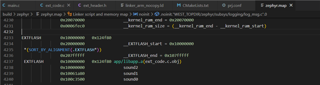

    I downloaded nRF Connect SDK 2.1.1 and tested the code_relocation_nocopy, modified it a little bit to declare some const big arrays located in external flash, and everything seems to work fine, their address show they are effectively located in ext_flash, and they are accessible from main() application located in primary_flash. If it is not too much to ask, could you give it a quick look just to make sure that what I have just said is correct regarding data location?
    If that's the case, I will stick to this approach as you suggested in your first response, and try to addapt it to our current nRF connect SDK 1.7.1 (otherwise I would have to migrate the complete project, which may take longer).
    I see that the example has changed, but I doubt there are any changes to the build system that would make it impossible to do something similar. I will check with the developers to be sure, and get back to you.
    I look forward to hear any usefull info regarding this, and also mark your answers as verified, as code_relocation_nocopy seems to be working perfectly!
    Thanks a lot for your help! Raised hands

    Thanks for sharing the code. I tested it here and it seems to work very well in v2.2.0.
    I also verified that the data is written to the right place by reading the variables using nrfjprog:
    C:\WINDOWS\system32>nrfjprog --memrd 0x1000004e --n 32
    0x1000004E: 0001 0002 0003 0000 0000 0000 0000 0000   |................|
    0x1000005E: 0000 0000 0000 0000 0000 0000 0000 0000   |................|
    C:\WINDOWS\system32>nrfjprog --memrd 0x10030d8e --n 32
    0x10030D8E: 000B 000C 000D 0000 0000 0000 0000 0000   |................|
    0x10030D9E: 0000 0000 0000 0000 0000 0000 0000 0000   |................|

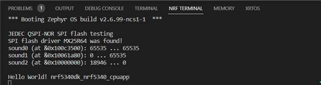

  • Hi Torbjørn,
    Thanks a lot for verifying the correct location of the variables in code_relocation example sent.

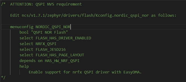

    I believe part of the issue is down to the ext_mem_init.c implementation, which configures the QSPI

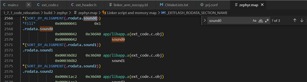

    I got the same problem when trying to adapt the code for SDK 1.7.1. I took a different approach for trying to skip that issue by enabling the QSPI flash at prj.conf with CONFIG_NORDIC_QSPI_NOR=y, and then getting device binding in main.c with flash_dev = device_get_binding(FLASH_DEVICE) through Device Tree, I might messed up things a little bit, but basically I think I'm using the flash driver.
    I attach this code, named 1_7_1_code_relocation inside the zip file, and basically project compiles, but variables are not correctly located in external flash, and I also get warning: memory region `EXTFLASH' not declare
    On the other hand, I took a different approach removing code_relocation usage, still using a custom LD file, and declaring const variables in the defined memory region with __attribute__((section ("EXTFLASH"))), which according to the documentation is basically the same in a more "handmade" way, if I didn't get it wrong (without considering XIP). This code is named 1_7_1_no_code_relocation in the attached zip.
    With this approach, variables seem to be correctly mapped, both at the zephyr.map file, and at the variables addresses being printed at console. BUT, the values declared for the variables are apparently not being stored. Should I be using the flash_read() API for getting this values, instead of just trying to access to them? Is this approach somehow wrong and shouldn't be considered for declaring variables?
    Here are both projects attached, in case you want to try them there, I think there may not be many differences between using SDK 1.7.1 and 1.8.0. One detail to consider is that I did a little mod in the QSPI Kconfig inside zephyr directory, which was recommended in a different and older thread here at the forum.
