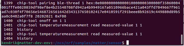

Adding clusters to Matter application read measured value keeps giving 0
Hi! I am a junior developer trying Matter out and I was following some documentations to to integrate sensors with the NRF52840 Development Kit to retrieve readings.
So far, I have been able to follow the examples for ADC to integrate an analog sensor (I'm starting with a light-dependent resistor to keep things simple) and have been successful in getting a reading out of it! I have also been able to add Matter clusters, build, flash and send commands to it based on the Template documentation and Adding clusters to Matter application documentation. However, during the integration, I could not help but realize that prior to integrating the sensor (actually, I successfully validated the analog pin's integration by reading its value within the Init function before deciding to take a step back, actually, I believe the use case I would be looking for would be IlluminanceMeasurement instead, but as I am following the documentations, I removed the sensor from the process and am thus using TemperatureMeasurement), the MeasuredValue is 0 as shown in the image below where I am using the Linux CHIP tool even after running the command multiple times:
Attached below is the configuration rendered by the ZAP tool for all my enabled clusters:
I have enabled OnOff attribute and commands for the cluster as shown below.
I have also enabled the MeasuredValue attribute Temperature Measurement as shown below.
I have also followed the other steps in the documentation, and have tried to trace various parts of the code to see that the task used to generate a randomized temperature does not appear to run. I have also managed to validate that the end device (NRF52840 development kit) is receiving commands from the CHIP tool as shown in the attached log file (I used screen to log this data):

I would like to know if this is intended behavior, and if not, how I could fix this issue to get a non-zero reading. Do let me know I need to upload any code! Thank you!
    I've had a look at your case and I think I need some more information to be able to isolate the issue. It seems to me that you're following the guide correctly based on your description of how you've done it, but just to be sure: did you activate the sensor by sending a On command?
    In addition, could you supply us a log that shows all of the chip-tool commands you send and the logs following for us to have a look at?
    Andreas
  • Hey Andreas,
    Thank you for reaching out!
    Attached below is a log of the chip-tool commands that I have used:
    The corresponding logs are as shown below::

    Here is the link to the repository for the code I have done up so far if it helps! Thank you!
    Side note: Where should I start looking if I would like to send commands remotely and not directly connected to a Wifi router? I have tried looking at this tutorial: openthread.io/.../openthread-border-router-nat64 but it does not seem to address my concerns about connecting to a Matter device! I think pointing me towards the right tutorial would be sufficient! Let me know if I should open another ticket for this!
  • Hey Andreas,
    I was looking through my code in this repo: https://github.com/justanotherkendrik/matter-sensor-example (I created a public repo here to hopefully make it easier to work with), and I do not see anything of that sort... Could making changes in `template.zap` cause this issue though?
  • Thank you for sharing. We're still lagging behind on possibility to recreate the sample due to some internal delay... I will ask around if any of my colleagues have the oportunity to handle the case for me while I'm OoO until next week. If not, then we will unfortunately have to wait for a hardware solution..
    Andreas
    Please try to delete "uint8_t mask," in the function MatterPostAttributeChangeCallback. This argument should not be included.
    Charlie
  • Oh hey, that worked! Thank you very much for reaching out! "uint8_t mask" was provided in the example given in the walkthrough, so I didn't think it could be that! I'm getting whole numbers populated in the measured values now (this seems like the correct output we should be getting)! The screenlog is available below:

    D: 665349 [IM]Received Read request
    D: 665353 [DMG]IM RH moving to [GeneratingReports]
    D: 665358 [DMG]Building Reports for ReadHandler with LastReportGeneration = 0 DirtyGeneration = 0
    D: 665367 [DMG]<RE:Run> Cluster 402, Attribute 0 is dirty
    D: 665372 [DMG]Reading attribute: Cluster=0x0000_0402 Endpoint=1 AttributeId=0x0000_0000 (expanded=0)
    D: 665381 [DMG]<RE> Sending report (payload has 38 bytes)...
    I: 665389 [EM]<<< [E:25392r M:248697776 (Ack:252961790)] (S) Msg TX to 1:000000000001B669 [0EBD] --- Type 0001:05 (IM:ReportData)
    I: 665400 [IN](S) Sending msg 248697776 on secure session with LSID: 56923
    D: 665408 [DMG]<RE> OnReportConfirm: NumReports = 0
    D: 665413 [DMG]<RE> ReportsInFlight = 0 with readHandler 0, RE has no more messages
    D: 665421 [DMG]IM RH moving to [AwaitingDestruction]
    D: 665425 [DMG]All ReadHandler-s are clean, clear GlobalDirtySet

    Since this variable was provided into the function for the tutorial given, will it be updated? Let me know if there is anything I can do to help!
    I'm glad you managed to get it to work!
    Yes, this will be updated. We've brought this up to the Matter developers and tech writers and the tutorial will be updated to acommodate the change in MatterPostAttributeChangeCallback
