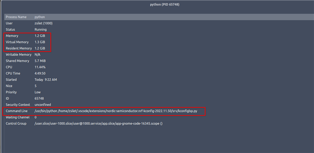

    Can you please provide the output of the extension command - nRF Connect: Generate Support Information as well?
    It throws an error into the VSCode output window every 1-2 minutes. This is annoying since it pulls focus from the terminal window even while one is actively interacting with the terminal).
    What error does it throw?
    It is using a massive amount of CPU and memory resources (causing computer to freeze pretty often). System monitor shows the underlying python process consuming anywhere from 1-2 GB of RAM at steady state, with spikes up to 5 GB.
    What python process is this, are you able to provide more information?
    Thanks.
    Øyvind
  • Hello Øyvind,
    Thank you for your quick response.

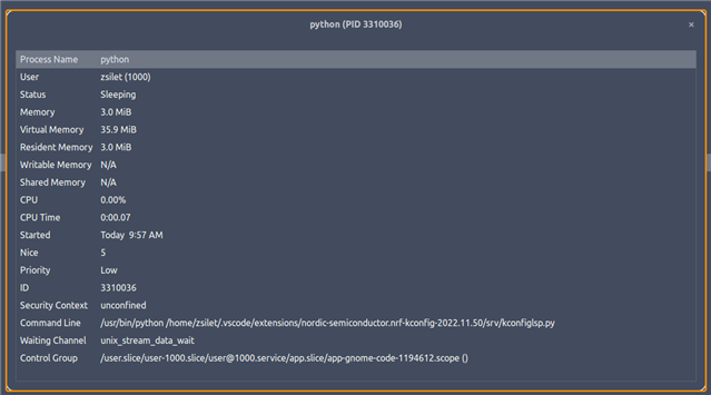

    I have re-enabled the Kconfig extension to reproduce the issue, but so far I have only partially reproduced it. At the moment, I see issue 1) (continuously throwing errors), but I do not see issue 2 (cpu/memory usage).
    Regardless, I am attaching the info you requested, as follows:
    1. A log of >2400 errors thrown over the course of a day
    2. The Generate Support Information output
    3. Screenshot of the python process that was using too much memory (and is currently working fine).
    As soon as I reproduce the resource usage issue, I will add evidence of it.

  • Hello Øyvind,
    The issue started happening again today (since 9:22AM when I booted my machine and started VScode, it has now been erroring for more than 6.5 hrs).
    The memory consumption is not as bad as it was when I first saw it, but it's still significant.
    I have included the VSCode output logs and a screenshot of the python script's process profile.

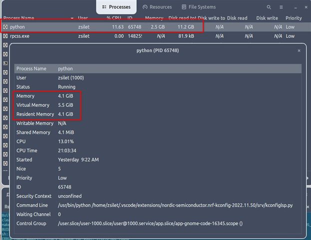

  • Furthermore, it seems that the memory usage is steadily growing... there may be a memory leak at play here.
    Here is the situation about 24 hours later. At this point my machine is starting to bog down, will need to restart.
