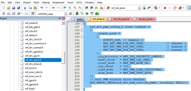

Undefined symbol nrf_drv_pwm_init (referred from main.o).
Hello, I am trying to modify my code by adding lines from a PWM example code.
However, I keep facing the same error message.
.\_build\nrf52832_xxaa.axf: Error: L6218E: Undefined symbol nrf_drv_pwm_init (referred from main.o).
code for this part is below,

static void pwm_init(void)
    nrf_drv_pwm_config_t const config0 =
        .output_pins =
            OUTPUT_PIN, // channel 0
            NRF_DRV_PWM_PIN_NOT_USED,             // channel 1
            NRF_DRV_PWM_PIN_NOT_USED,             // channel 2
            NRF_DRV_PWM_PIN_NOT_USED,             // channel 3
        .irq_priority = APP_IRQ_PRIORITY_LOWEST,
        .base_clock   = NRF_PWM_CLK_1MHz,
        .count_mode   = NRF_PWM_MODE_UP,
        .top_value    = 100,
        .load_mode    = NRF_PWM_LOAD_INDIVIDUAL,
        .step_mode    = NRF_PWM_STEP_AUTO
    // Init PWM without error handler
    APP_ERROR_CHECK(nrf_drv_pwm_init(&m_pwm0, &config0, NULL));
I included these headers.
#include "nrf_drv_pwm.h"
#include "nrf_drv_clock.h"
And also checked whether they are contained in the project.
Does anyone have a clue about my problem, or can you help me to solve this issue?
  • Howdy! Note that driver implementations usually have compiler guards that keep the source code from being compiled unless the driver has been enabled in your sdk_config.h. In SDK 17 the nrfx_pwm.c has "#if NRFX_CHECK(NRFX_PWM_ENABLED)" at the top so check your sdk_config.h and make sure that you have NRFX_PWM_ENABLED defined as 1. If you look at the sdk_config.h in the original PWM example that you are taking code from you'll probably find some other NRFX_PWM-related symbols that you'll need to copy into your sdk_config.h.
  • Howdy! It might be a stupid question, but I could find neither of the NRFX_PWM_ENABLED in the sdk_config.h or nrfx_pwm.c from the project tree.
    However, I found PWM enabling code from the sdk_config.h, so I changed it as 1
    #ifndef PWM_ENABLED
    #define PWM_ENABLED 1		//originally 0
    #if  PWM_ENABLED
    #ifndef APP_PWM_ENABLED
    #define APP_PWM_ENABLED 1		//originally 0
    #ifndef LOW_POWER_PWM_ENABLED
    #define LOW_POWER_PWM_ENABLED 1			//originally 0
    Unfortunately, the same error messages have appeared.
    Do you think I am missing something?
  • It looks like you're using a quite old version of the SDK. Back in SDK 14 the driver was just called nrf_drv_pwm but the same idea applies. If you look at the top of nrf_drv_pwm.c you'll see an additional compiler guard
    #define ENABLED_PWM_COUNT (PWM0_ENABLED+PWM1_ENABLED+PWM2_ENABLED)
    #if ENABLED_PWM_COUNT
    so make sure you have at least one of the PWMX_ENABLED constants set in your sdk_config.h. In fact, I'd probably just copy all of the PWM stuff from "examples/peripheral/pwm_driver/pca10040/blank/config/sdk_config.h" starting at line 133. Once it compiles you can go back and adjust the values as necessary.
  • Thank you very much!
    Actually, I enabled all the options that are relevant to the PWM, and it works now!!
