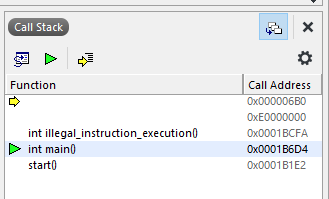

However, it seems that we never reach our HardFault_Handler() implementation!
To test if we can properly reach our HardFault_Handler() implementation we created a custom illegal_instruction_execution() function that will cause the HardFault and tried to call that function in the code. The content of the function is as follows:
static int illegal_instruction_execution(void) {
  int (*bad_instruction)(void) = (void *)0xE0000000;
  return bad_instruction();
The function is properly causing the HardFault because we can clearly see it from the function Call Stack:
However, it seems we don't enter into our custom HardFault_Handler() function. Do you have any idea about what we are missing here?
