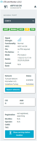

I'm Bunyamin from Turkey. I've obtained an nRF9160-DK and inserted a TURKCELL M2M SIM card.
1- I installed modem firmware mfw_nrf9160_1.3.3
2- I flashed nrf9160dk_asset_tracker_v2_ltem_2022-06-02_880c82db.hex (or nrf9160dk_asset_tracker_v2_nbiot_2022-06-02_880c82db.hex , I get the same result)
3- I connected to nRF9160-DK with LTE Link Monitor

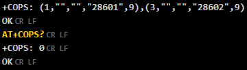

4- I sent the AT commands below:
->> AT+CFUN=0
->> AT+CEREG=5
->> AT+CSCON=3
->> AT%XEPCO=0
->> AT%XSYSTEMMODE=0,1,1,0
->> AT+CGDCONT= 0,"IP","nbiot"
->> AT+CFUN=1
->> AT+CFUN?
5- After these commands, I receive the log below:

2023-01-06T09:16:28.435Z DEBUG modem << %CESQ: 22,1,14,2
2023-01-06T09:16:28.447Z DEBUG modem << +CEREG: 2,"1600","0042DC67",9
2023-01-06T09:16:28.960Z DEBUG modem << +CSCON: 1,7,4
2023-01-06T09:16:29.445Z DEBUG modem << [00:01:27.484,741] [0m<inf> app_event_manager: MODEM_EVT_LTE_DISCONNECTED[0m
2023-01-06T09:16:29.452Z DEBUG modem << [00:01:27.485,382] [0m<inf> app_event_manager: MODEM_EVT_LTE_CELL_UPDATE[0m
2023-01-06T09:16:29.784Z DEBUG modem << %CESQ: 26,1,9,1
2023-01-06T09:16:30.723Z DEBUG modem << +CNEC_EMM: 15
2023-01-06T09:16:30.730Z DEBUG modem << +CEREG: 2,"1600","0042DC67",9,0,15
2023-01-06T09:16:30.789Z DEBUG modem << +CSCON: 0,7,4
2023-01-06T09:16:31.459Z DEBUG modem << %CESQ: 255,0,255,0
2023-01-06T09:16:31.465Z DEBUG modem << +CEREG: 2
2023-01-06T09:16:32.468Z DEBUG modem << [00:01:30.507,293] [0m<inf> app_event_manager: MODEM_EVT_LTE_CELL_UPDATE[0m

2023-01-06T09:21:53.622Z DEBUG modem << +COPS: (1,"","","28601",9),(3,"","","28602",9)
2023-01-06T09:21:53.625Z DEBUG modem << OK
2023-01-06T09:21:53.633Z DEBUG modem >> AT+COPS?
2023-01-06T09:21:53.642Z DEBUG modem << +COPS: 0
2023-01-06T09:21:53.645Z DEBUG modem << OK

6- Still AT+COPS=0. I cannot connect to the operator (TURKCELL).
7- It is interesting that, I receive +COPS: (1,"","","28601",9),(3,"","","28602",9) than +COPS: 0 again.
Can anyone help me?

    Both reject causes point to a problem with your subscription and/or coverage.
    Does your SIM card support NB-IoT or LTE-M (you only have NB-IoT enabled in the log)?
    Is there NB-IoT coverage at your location?
    Didrik
  • Hi Didrik,
    Thanks for your reply.
    I called TURKCELL support center and asked the settings of APN. Than, I made the APS settings as NBIOT. So, the problem solved. Now, I can connect the operator (TURKCELL).
    AT+COPS?
    +COPS: 0,2,"28601",9
    OK
    Thanks for your advice.
