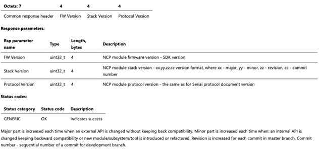

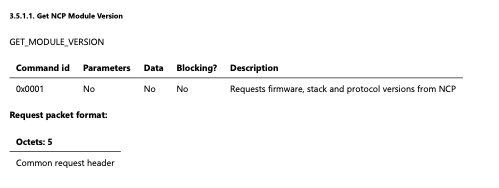

I'm using the ZBOSS NCP sample from NCS v2.2.0 and flashed the nRF52840 DK after building it.
I am able to communicate with the NCP from the host, but I don't get how versioning is working.
I get this from the NCP:
- FW version: 0.0.0.1
- Stack version: 3.11.2.0
- Protocol version: 0.0.1.21
(Raw data I get from the version command -> "01:00:00:00:00:02:0B:03:15:01:00:00" in little endian with 4 bytes for each version types)
My question is, do I need to set the firmware version? Why is it not 2.2.0.0 (like the NCS version I was using when building)?
I think I understand the stack and protocol version. Stack version is simply the ZBOSS version used by NCP and protocol version is the document version used for the ZBOSS NCP protocol description.
