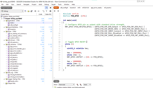

The issue is not the hardware though. I got a Programm running in Segger Embedded Studios which turns a LED on and off. Thats why i know that the Hardware works.

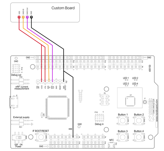

I did upload the programm using a nRF52_DK as shown in the picture. This worked well.

    So if I have understood you correctly, you are able to program the custom board using Segger, but you are not able to program it using VSC? In that case I don't think the board or the code is the problem. I would rather think there are some files that haven't been correctly configured in VSC (eg. an overlay file that VSC isn't seeing).
    Why doesnt it work if i upload the programm with the board configuration form the nRF52832_DK? (if i put the leds and buttons on my custom board on the same pins as on the DK should it work then?)
    This sounds like a potential problem, but if it did work in SES then it shouldn't be an issue at the moment. If everything you need to eg. blink an LED was the same in the DK dts files and your custom boards dts files you might as well just use the dts files for the 52DK for this test. Either way, if you did indeed manage to program the custom board using SES then the board files shouldn't be the issue.
