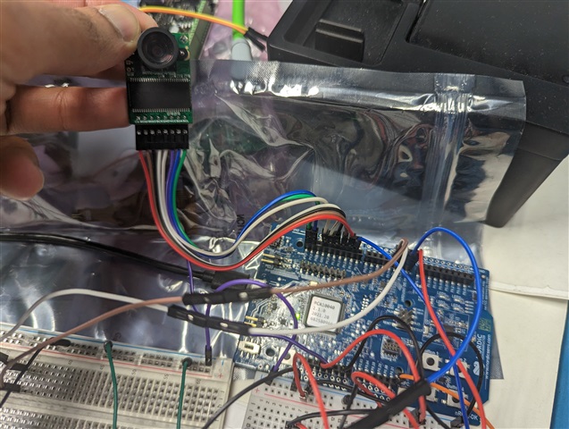

I am trying to use the drivers from the following repository: https://github.com/too1/ncs-arducam-mega-driver
I and using the latest version of the NCS 2.2.0, I am using the nRF52 DK nRF52832 eval baord, finally I have the Arducam OV5642 camera module.
I also made a custom overlay file for the nRF52 DK.
I mange to build and flash the driver code to the board, but I am not getting any out on the RTT terminal and the VCOM0 terminal doesn't connect.

I have connected the Arducam to the nRF52 DK as illustrated in the older repository: https://github.com/NordicPlayground/nrf52-ble-image-transfer-demo
Note: The OV2640 and OV5642 have the same pinouts and I am using the side connector of the nRF52 DK.
Please see the attached pictures of the setup below:
Please let me know if any other information is required.
Adnan
  • Hi Adnan
    The ncs-arducam-mega-driver is designed for the newer Arducam Mega module. A big difference with this one compared to the older one you are using is that the Arducam Mega uses SPI only, while the older Arducam module needed both an SPI and an I2C connection.
    In other words the example will not work with the older module, and you would need to get the Arducam Mega instead.
    My apologies if this wasn't made clear earlier...
    Best regards
    Torbjørn
