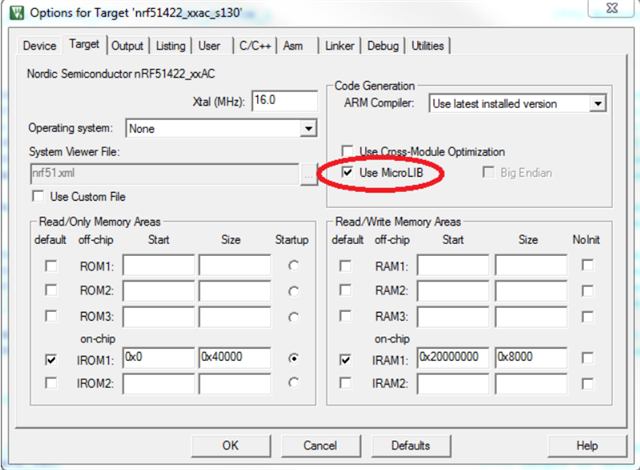

    Please make sure this box is not checked in your target settings:
    Having microlib enabled will cause the HEAP section to be removed.
    Vidar

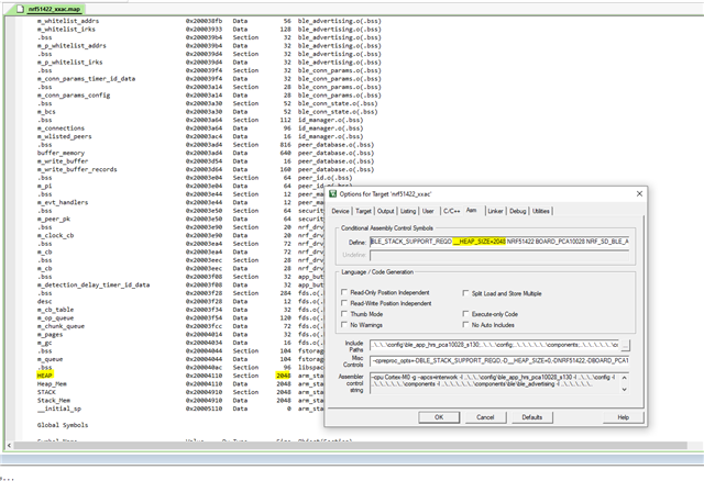

    I increased the HEAP size and all my problems went away.
  • I did increase the HEAP size but I did it directly in the assembly code. I also needed to increase the STACK size for another version of the model but again, I did it directly in the code. When I looked at the preprocessor defines for my settings, their was neither a HEAP or STACK size option present. If I use the preprocessor above will that override the values in code?
    What is the preprocessor for STACK size?
    __STACK_SIZE
