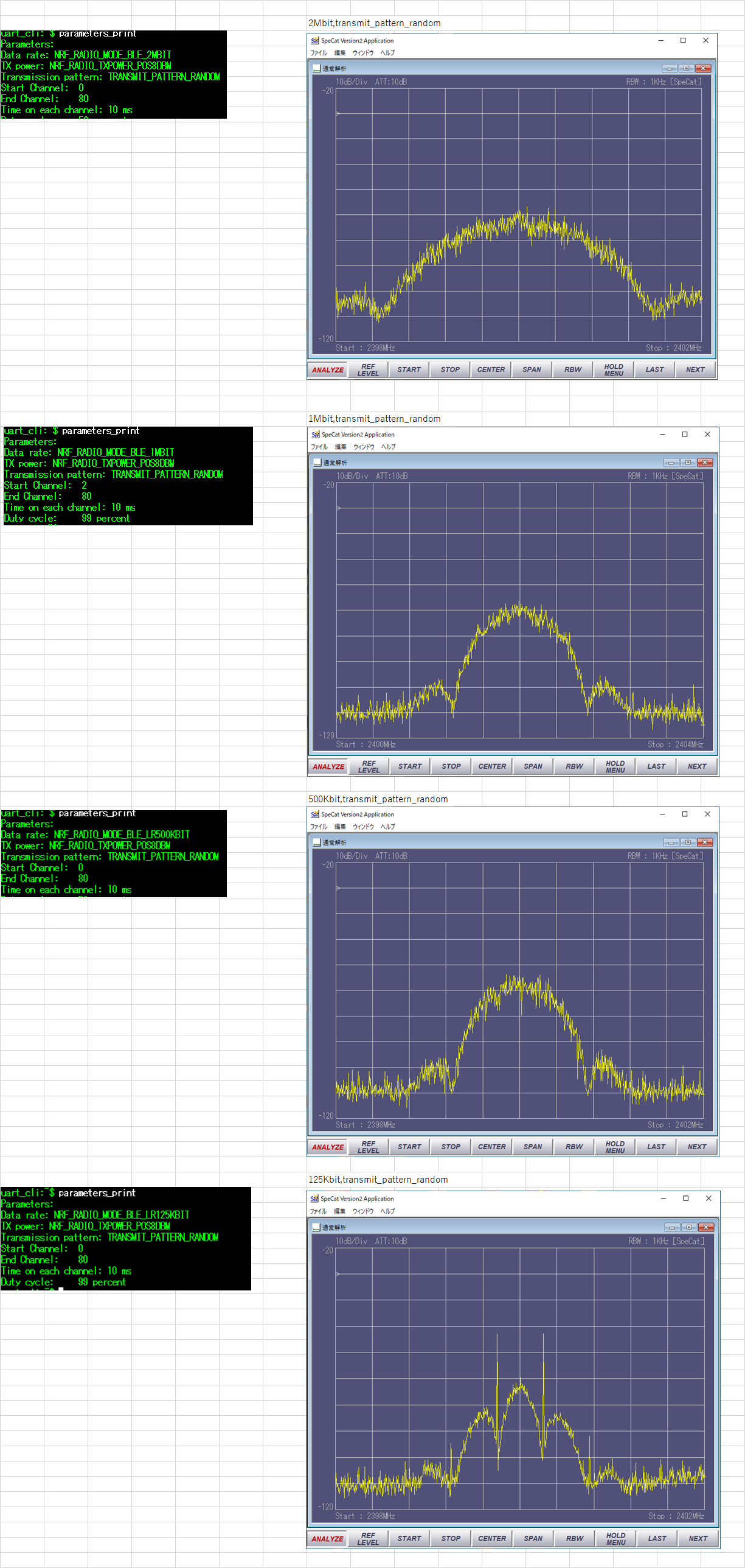

How to maximize DUTY with PRBS9 using DTM?
I will place an order with a testing company to test EN300328 emissions for a product using the nRF52840.
I received an instruction from the testing company to prepare a sample with the following conditions.
 1.Continuous modulation transmission
 2.Transmission CH is minimum and maximum
 3. Maximum Duty
 4.PRBS9
 5. Maximum transmission power
I want to set this condition using Direct Test Mode V2.02.
(Direct Test Mode is running on a PC.)
I have set below.
  CHANNEL MODE:Single
  Transmit on channel: 37/39
  Transmit power: 8dbm
  Physical layer: LE Coded S8/LE 1Mbps
  Packet type: PRBS9
  Packet Length: ?
 No timeout
So here's the question.
Q1.
There is no duty in the setting items, but what is the duty percentage?
Q2.
How can I set the duty to maximum?
Q3.
Any value for Packet length has nothing to do with the necessary conditions?
Perhaps there is a relationship between Packet length and Duty?
that's all. Thank you.

  • toshi.g said:
     1.If I use start_duty_cycle_modulated_tx in radio_test, I can set a random value with duty99% and send it.
    It's better to use start_tx_modulated_carrier as this will give you 100% duty cycle
    toshi.g said:
    2.Random value seems to be generated by nrf_rng_random_value_get.
    Yes, this have random payload
    toshi.g said:
     According to the standard, it is necessary to test in a state that gives the worst result.
     There is no problem if you can guarantee that the method(nrf_rng_random_value_get) other than PRBS9 is Worst.
    Yes, this will give the widest carrier bandwidth as the data is random, similar to PRBS9. PRBS is just a method to generate random numbers.
