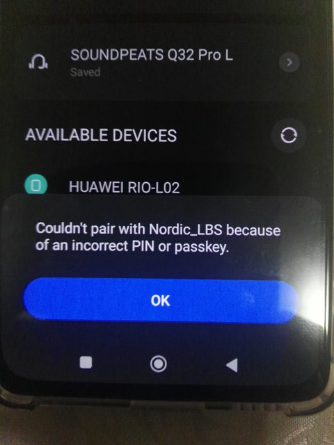

Apologies if this question has been asked previously but I recently received my Nordic Thingy 53 device and for the life of me the device will not connect to the Bluetooth on my multiple Android devices as connection fails due to in correct PIn or passcode.

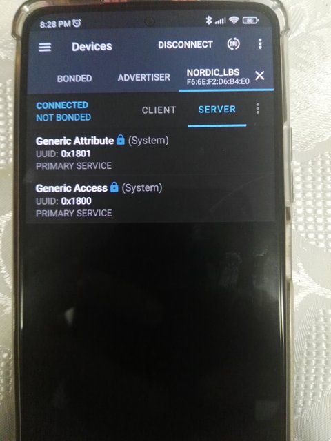

Initially the device connected to my phone as I was able to load some samples using nRF Programmer mobile application however once I went to the Edge Impulse application my phone doesn't connect to the device and asks to make sure I have updated firmware or charged device and any attempts at reconnecting fail as the unit shows on Bluetooth but cannot connect and factory resetting my phone does nothing to solve the connection issue? The device will show on nRF Connect yet doesn't always Bond or Connect and if I try pairing it fails due to the PIN error!?

  • So I managed to update Peripheral LBS using the nRF Programmer app on Android using MIUI Global 13.0.9 (Android 12) and the Poco F3 sees the Nordic LBS in Bluetooth but when I pair I get the "Couldn't pair with Nordic_LBS because of an incorrect PIN or passkey" and in Edge Impulse it can't find any device?

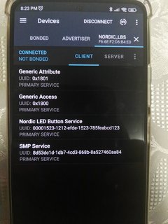

    nRF Connect app sees the device as Nordic_LBS and will connect but not Bond so not sure what is stopping it from pairing to Bluetooth as I tried a Huawei phone and Lenovo tablet with first attempt asking to authorize yet the device quickly disappears and won't connect so any assistance would be greatly appreciated. Thank you.
  • OK so I'm not sure what I did but I went and installed EdgeImpulse from nRF Programmer app which was successful. That allowed me to pair the device and save it on my phones Bluetooth list. I then tried a few more apps such as nRF Connect and some how unlocked the SMP Service which was missing when I scanned for a device so now EdgeImpulse shows as Bonded.

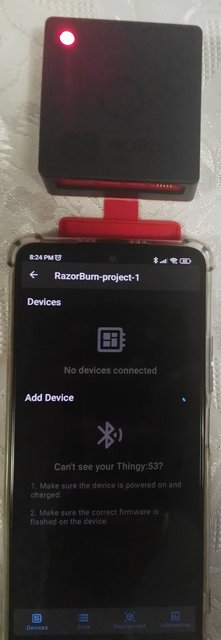

    I then tried Edge Impulse app and successfully added the device yet its still not showing up in Device Manager app as the message says:
    2. Make sure the firmware with SMP server is flashed and device is advertising.
    3. Check the filter settings. By default, the scanner displays only devices that advertise SMP service UUID (8D53Dc1D-1DB7-4CD3-868B-8A527460AA84)
    I also see no device in nRF Bluetooth LE Joiner but I'm not sure if Thingy 53 actually uses that app so its not important.
    How do I resolve the SMP server issue as nRF Connect lists the SMP Service details of the Bonded Device with a UUID number so why isn't that showing in Device Manager...?
