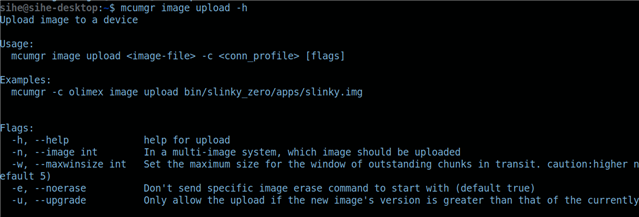

    3. What mean -n flag for mcumgr ? It is not visible in help of utility ?

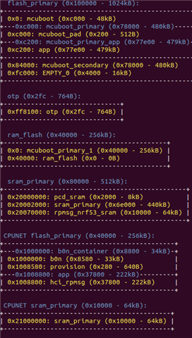

    4. How networkapplication hci_rpmg defined as child project ? Definition is not visible in project files. Looks as some trick.
     5. MCUBoot is visible as child image but n0b bootloader not. Does it appears somehow automatically ?
    Also see https://docs.zephyrproject.org/3.2.0/services/device_mgmt/mcumgr.html.
    and my own explanation from https://github.com/hellesvik-nordic/samples_for_nrf_connect_sdk/tree/main/bootloader_samples/smp/mcuboot_smp#extra-steps-for-the-nrf5340:
    The -n numbers are set as follows:
    slot 0 - image 0 primary
    slot 1 - image 0 secondary
    slot 2 - image 1 primary ("Virtual" slot)
    slot 3 - image 1 secondary
    From Working with nRF5340 DK, you can see that if CONFIG_BT=y, the build system will add hci_rpmsg to the system.
    Try to add a print to the sample, and see your net core print it on the net-core VCOM.
    It is because n0b is a child image of hci_rpmsg.
    You can see it at build/hci_rpmsg/b0n.

    Partition info looks correct:
    $ west build -t partition_manager_report
    -- west build: running target partition_manager_report
    [...build/cpunet/partitions_CPUNET.yml
      flash_primary (0x100000 - 1024kB):
    | 0x0: mcuboot (0x18000 - 96kB)                    |
    +---0x18000: mcuboot_primary (0x74000 - 464kB)-----+
    | 0x18000: mcuboot_pad (0x200 - 512B)              |
    +---0x18200: mcuboot_primary_app (0x73e00 - 463kB)-+
    | 0x18200: app (0x73e00 - 463kB)                   |
    | 0x8c000: mcuboot_secondary (0x74000 - 464kB)     |
      otp (0x2fc - 764B):
    | 0xff8100: otp (0x2fc - 764B) |
      ram_flash (0x40000 - 256kB):
    | 0x0: mcuboot_primary_1 (0x40000 - 256kB) |
    | 0x40000: ram_flash (0x0 - 0B)            |
      sram_primary (0x80000 - 512kB):
    | 0x20000000: pcd_sram (0x2000 - 8kB)        |
    | 0x20002000: sram_primary (0x7e000 - 504kB) |
     CPUNET flash_primary (0x40000 - 256kB):
    +---0x1000000: b0n_container (0x8800 - 34kB)-+
    | 0x1000000: b0n (0x8580 - 33kB)             |
    | 0x1008580: provision (0x280 - 640B)        |
    +---0x1008800: app (0x37800 - 222kB)---------+
    | 0x1008800: cpunet (0x37800 - 222kB)        |
     CPUNET sram_primary (0x10000 - 64kB):
    | 0x21000000: sram_primary (0x10000 - 64kB) |
    Looks like I should inform mcuboot or/and b0n that image in that slot and force update somehow.

    To upload to the netcore, use
    mcumgr  -c acm1 image upload build/zephyr/net_core_app_update.bin  -n 3
    Then wait for ca 2 minutes before restarting the device.

    $ mcumgr -c acm1 image upload build/zephyr/net_core_app_update.bin -n 3
    181.71 KiB / 181.71 KiB [===============================================================================================================] 100.00% 1.80 KiB/s 1m41s
    Done
    App image is also uploaded to some space
    $ mcumgr -c acm1 image upload build/zephyr/app_update.bin
    58.02 KiB / 58.02 KiB [=====================================================================================================================] 100.00% 956 B/s 1m2s
    Done

    Partition info
