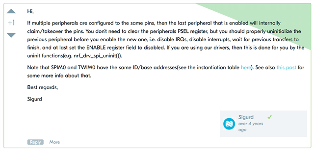

I then conducted more DevZone research to see if anyone else attempted this or found a different solution, and saw this in a similar topic:
My question then is: as I implement a driver that will allow me to use the QSPI bus for 2 devices, I plan to change the CSn pin via the code above every time I need to change between devices. How important or relevant do you think it is that I un-initialize the QSPI bus or the target devices for every R/W operation? Are there any known fixes or updates out/coming out soon? As I see it, the only limitation is in the driver, and if the QSPI driver accepted a different CSn pin for each device then this would not be a problem.

    Conseptually it should not be a problem to write software that can use the QSPI for various devices, the same applies also to SPI. HOWEVER, there is not built in support to handle this dynamic switching (e.g. in terms of interrupt, power management, and peripheral configuration that may differ due to usage) in the zephyr drivers, so it will cause problems if you try use a ready-made driver in zephyr that use QSPI and then change only the psel register for CSN. But if you have full control over the serial transfer and have your own implementation of for instance the interrupt handler, then this should not be a problem to do what you want to do.
