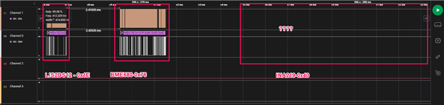

I am going through various sensors on my custom board and integrating them one by one. I've got "i2c0" peripheral setup and can talk with BME680, LIS2DS12 no problem. I am having some issues with LIS2DS12 but I am not troubleshooting it yet.
What is strange, is that the thread that is requesting data from the INA219 run, but I see no I2C traces using my logic analyser. I can see I2C traffic for the BME680 and LIS2DS12, so I should see the INA219 since they are all on the same bus.

Here is the LA trace.
This is the output I am seeing.

  • Looks like you haven't fetched the data first.
    void initINA219(void){
    	const struct device *const ina = DEVICE_DT_GET_ONE(ti_ina219);
    	struct sensor_value v_bus, power, current;
    	int rc;
    	if (!device_is_ready(ina)) {
    		LOG_ERR("INA219  %s is not ready.", ina->name);
    		return;
    //	while (true) {
    		rc = sensor_sample_fetch(ina);      <---------------- HERE
    		if (rc) {
    			LOG_ERR("INA219 Could not fetch sensor data.");
    			return;
    		sensor_channel_get(ina, SENSOR_CHAN_VOLTAGE, &v_bus);
    		sensor_channel_get(ina, SENSOR_CHAN_POWER, &power);
    		sensor_channel_get(ina, SENSOR_CHAN_CURRENT, &current);
    		LOG_INF("INA219 Bus: %f [V] -- "
    			"Power: %f [W] -- "
    			"Current: %f [A]",
    		       sensor_value_to_double(&v_bus),
    		       sensor_value_to_double(&power),
    		       sensor_value_to_double(&current));
    //		k_sleep(K_MSEC(2000));
    Regards
    Mashall
