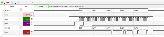

My setup is based on the SPI example program included in the nrfSDK nRF5_SDK_17.1.0_ddde560\examples\peripheral\spi\main.c
I've set up my SPI instance and am sending commands over to the Winbond flash memory.
However, I am only receiving 0x00 when I should be receiving the chip ID.
I've set the transfer and receive length to 5 as per this post:  SPIM nrf_drv_spi_transfer() usage
Since the command is 2 bytes long and I need to receive 3 bytes following.
You can see details of the SPI command on page 28 of the datasheet: https://www.winbond.com/resource-files/W25N01GV%20Rev%20O%20092619.pdf
I am wondering if I have set it up incorrectly or am not properly using the spi transfer function.

    Hmm, interesting. Can you also show us what the RX array variable shows when you watch it in debug mode on the board? Preferably a comparison between the GV and KV variants so we can see the exact difference in behavior. Also, are you seeing this issue on multiple boards, or are you testing on just the one. If you're just seeing the issue on the one board with the KV variant there's a chance it could be poor soldering on the MOSI/MISO pins that cause this issue as well.
    Simon
