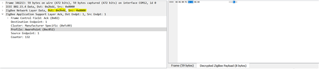

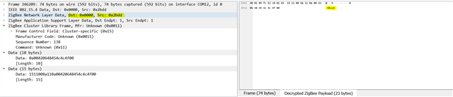

I can see the Packet sent from my End Device on my Wireshark:
and I can also see the ACK back from the Coordinator:
so the packet is sent fine, and received and also acked back, but the endpoint handler does not trigger.

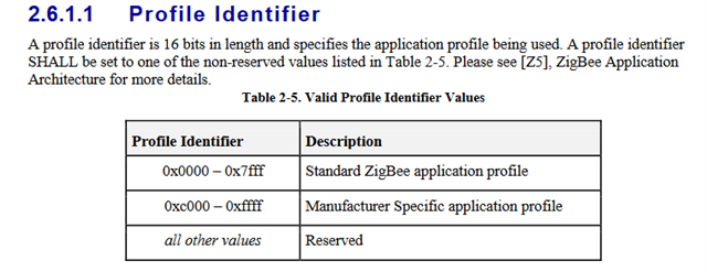

The fix was to change the profile ID value from my Own custom Profile ID to the HA profile ID (0x0104).
From the Zigbee ZCL specification section 2.6.1.1:
so using custom profile ID with values from this table should cause no problems.
The process of defining my clusters and attributes is standard, nothing new, just defined the attributes, then defined the Cluster list and cluster descriptors, declared endpoint, and device ctx. If additional steps are required to use custom profile IDs then I did not see them on the https://developer.nordicsemi.com/nRF_Connect_SDK/doc/zboss/3.11.2.0/index.html
